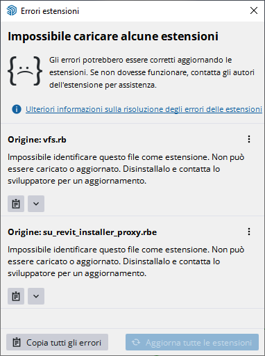

Buongiorno, ho scaicato Vray dal sito Tecnobit, ma dopo l’installazione, all’avvio di Skp, mi da errore di estensione.
Qui lo screen del messaggio, ed il
testo dell’errore:
Grazie.
Roberto
Rapporto errori estensioni
SketchUp: 25.0.660
Sistema operativo: Windows 10
Ruby: 3.2.2
Estensione: [unknown]
Errore: Errno::ENOENT (No such file or directory @ rb_sysopen - C:\Program Files/Chaos/V-Ray/V-Ray for SketchUp/extension/extension.json)
C:/ProgramData/SketchUp/SketchUp 2025/SketchUp/Plugins/vfs.rb:11:in read' C:/ProgramData/SketchUp/SketchUp 2025/SketchUp/Plugins/vfs.rb:11:in module:VRay’
C:/ProgramData/SketchUp/SketchUp 2025/SketchUp/Plugins/vfs.rb:5:in `<top (required)>’
Errore: Win32::Registry::Error (Impossibile trovare il file specificato.)
C:/ProgramData/SketchUp/SketchUp 2025/SketchUp/Tools/RubyStdLib/win32/registry.rb:289:in OpenKey' C:/ProgramData/SketchUp/SketchUp 2025/SketchUp/Tools/RubyStdLib/win32/registry.rb:431:in open’
C:/ProgramData/SketchUp/SketchUp 2025/SketchUp/Tools/RubyStdLib/win32/registry.rb:542:in open' c:/users/xeon/appdata/roaming/sketchup/sketchup 2025/sketchup/plugins/su_revit_importer_installer/su_revit_installer_proxy.rbe:30:in module:SURVTINSTALLER’
c:/users/xeon/appdata/roaming/sketchup/sketchup 2025/sketchup/plugins/su_revit_importer_installer/su_revit_installer_proxy.rbe:7:in <main>' C:/ProgramData/SketchUp/SketchUp 2025/SketchUp/Tools/extensions.rb:197:in eval’
C:/ProgramData/SketchUp/SketchUp 2025/SketchUp/Tools/extensions.rb:197:in require' C:/ProgramData/SketchUp/SketchUp 2025/SketchUp/Tools/extensions.rb:197:in load’
C:/Users/Xeon/AppData/Roaming/SketchUp/SketchUp 2025/SketchUp/Plugins/su_revit_importer_installer.rb:54:in register_extension' C:/Users/Xeon/AppData/Roaming/SketchUp/SketchUp 2025/SketchUp/Plugins/su_revit_importer_installer.rb:54:in module:SURVTINSTALLER’
C:/Users/Xeon/AppData/Roaming/SketchUp/SketchUp 2025/SketchUp/Plugins/su_revit_importer_installer.rb:7:in `<top (required)>’
Salve erre-ci,
vedo che si tratta di SketchUp 2025, per cui un primo suggerimento sarebbe di passare alla versione 2026. A prescindere dalla versione, gli errori riguardano V-Ray e Revit importer. Per cui è necessario disinstallare V-Ray dalle app installate in Windows, poi avviare SketchUp, dove probabilmente sarà ancora visibile l’errore riguardante Revit, passare quindi a Estensioni | Gestione estensioni, quindi clic sul tab Gestisci in alto, e proseguire aggiornando o disinstallando “Revit importer for SketchUp”. Chiudere e riavviare SketchUp per vedere se gli errori sono scomparsi. A Questo punto proseguire con l’installazione dell’ultimo setup di V-Ray, che, ad oggi, corrisponde al link qui sotto.
V-Ray 7.20.01
Dovrebbe funzionare. Ma resta valido il consiglio di passare a SketchUp 2026, nel qual caso l’installazione di V-Ray andrà fatta solo dopo che sarà installato e funzionante il 2026.
